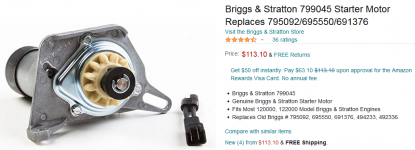

I have a Briggs and Stranton 29447-0445-01 motor on a cub 1440. I need a starter. I've looked all over the internet and can't find it. Anyone have a clue what the part number might be. Thank you.

Briggs part number 799045
Thank you. However, that isn't the correct one either. Now you get my dilemma. I have tried and cannot for the life of me find this starter. I do appreciate your effort!

Why do you say that is not the correct one? According to the model number you posted it should be correct. Are you sure no one has changed the shroud on the engine where you got the model number? Please post the code number for your engine, as there were three different starters used on that model, depending on code number, but they all supersede to the number I posted. Also post a couple of pictures of the starter you are trying to replace.

Just did a double check and I think you may be missing a digit in the model number you posted. Please double check if I’m wrong.
Boy are you off...
... and doesn't look anything either of the following starters.
294447-0445-01
Two starters available.
PN 691564 if your flywheel has a steel ring gear
or
PN 795121 if your flywheel has a plastic or aluminum ring gear
