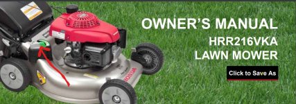

Right below your gas tank you should find a LIME GREEN lever called Clip Director. It's on the same side as where you add the oil. If you have that in the Mulch position and it's still leaving a trail, maybe your blades are dull or you're cutting deck needs cleaning.Honda Clip Director Location.jpg
