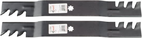

These are the blades that are listed as Gator Mulching Blades.
i wouldn't trust much the description on Amazon however, we can divide the blades into 3 types (standard, all-purpose, and bagging blades). I believe the one you listed is probably one of the all-purpose blades or in other words 3 in 1 blade (discharge, mulch, and bag).
