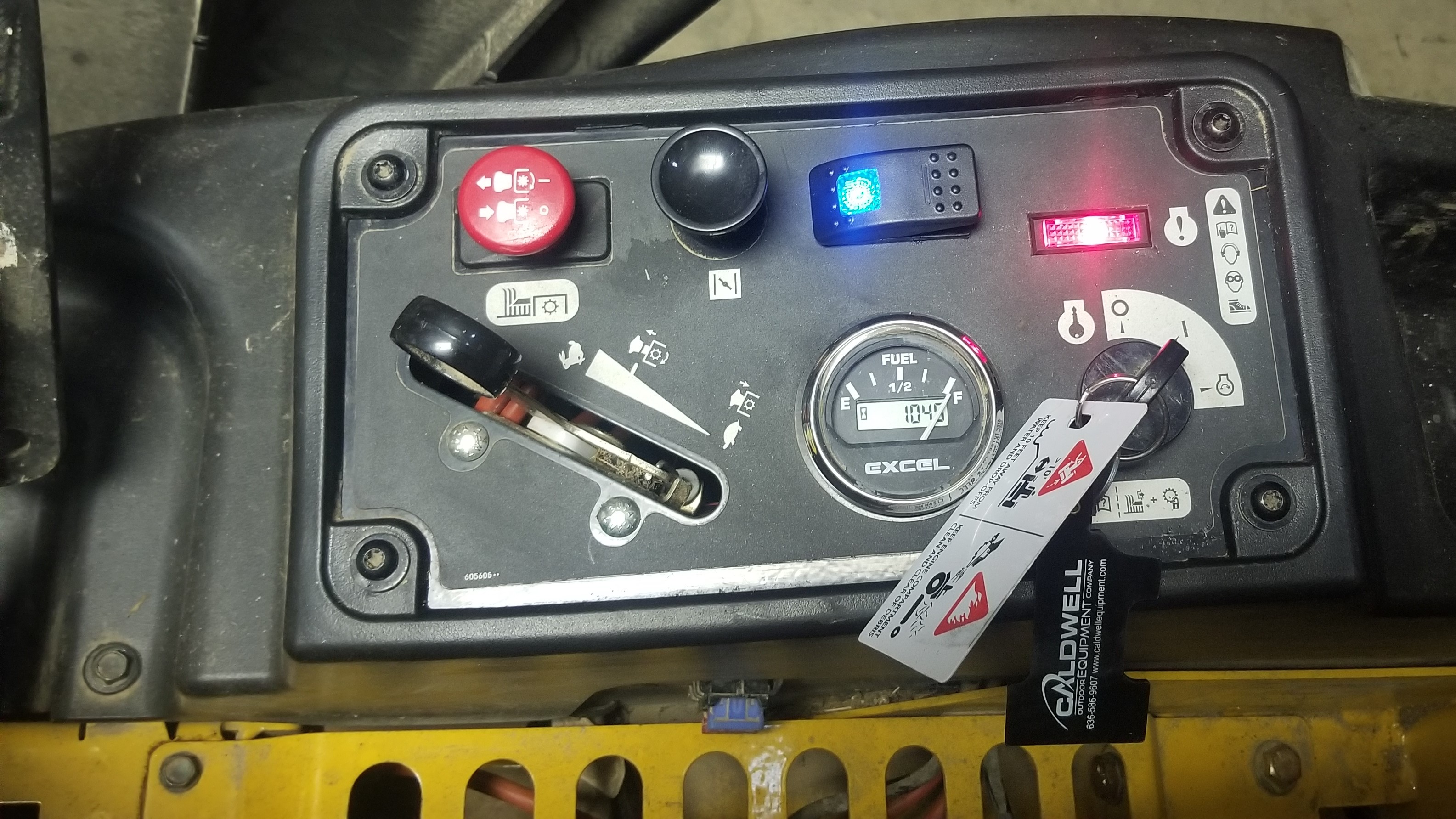

Since I already had the main power source for the old lights already in place, this was very very very easy to switch out. It was plug and play. For the rear lights, I simply purchased L brackets from Home Depot (due to the space limitation and the fact that the brackets for the light were non reversible) and bolted the L brackets into holes that were already in the engine guard.
