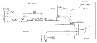

Check your seat switch. It becomes the only path to keep the engine kill relay active once the PTO switch is pulled. This provided the engine is being electrically killed.
Now if you are able to drive around mower without the PTO engaged the seat would be working. Also the start relay might have burned contacts not allowing the seat switch to provide voltage for the kill relay. Otherwords Hustler made necessary for the operator to be on the seat.

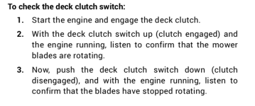

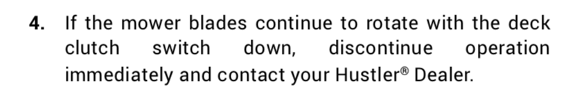

I have a Hustler Raptor Flip-up with a 54" deck that I've owned, brand new, since 2015.....so it definitely is a different model altogether, from yours.
Don't know if this helps or not but check your Operators Manual concerning your Deck Clutch, engaging, etc.?
The Operators Manual (pages 3-10 & 3-11 respectively) for my ZT states the following when engaging the Deck Clutch (PTO):
Again, just my $0.02 about all this.
Hopefully you'll get your problem solved and all worked out and if you do get it resolved post details about it here on this thread you created.
