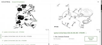

Isn't it just a stator under the flywheel on the motor? I will follow the harness back and get the regulator. I know the igniters are a little different too....245 electrical.jpg
There may be fewer magnets on inside of flywheel also. I put Kohler CV15S in place of a Kawa 14HP and had to change stator and flywheel.
