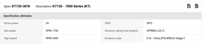

I ILENGINE Lawn Royalty Joined May 6, 2010 Threads 39 Messages 10,091 Jun 3, 2023 / Lower idle speed on Craftsman T310 #2 Need to confirm either serial number or the model number of the engine, because that serial number is coming back to a SH265-3152 engine If you have the KT series 7000 engine then 1750 would be a good idle speed.
StarTech Lawn Royalty Joined Feb 19, 2020 Threads 80 Messages 10,333 Jun 3, 2023 / Lower idle speed on Craftsman T310 #3 Definitely a KT735-3076.
