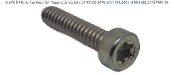

On the "D5" Stihl screw thread designation, I think you're past needing the information, but I tried to find an answer out of curiosity. I couldn't find a clear definitive explanation, but it appears Stihl bolt part numbers starting with "D" are self-tapping screws typically used for muffler/exhaust attachment.
I think the "5" means 5mm diameter (M5). I see some Stihl screw numbers starting with D5, others starting with D5.3, followed by "x" and two numbers (example: "x 24") obviously meaning length in mm.
The "D5.3" could mean a slightly larger 5.3 mm diameter, or perhaps the ".3" is an option code, such as thread pitch, head style, or finish or plating. Anybody's guess at this point. Perhaps a Stihl dealer could clear up the mystery.
Attached is one D5 Stihl screw listing that I found on line.
