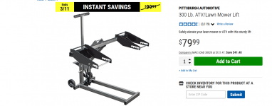

#12
Works great
Pshhhhh. :ROFLMAO: :ROFLMAO: :ROFLMAO: 80 bucks! worth every penny until it crushes you.
#13
100 td
My 800mm lift floor jack does the job for what I need but at $80 it would sure make things easy for some folks.

Hammermechanicman
Hammermechanicman
I have that HF lift and retired it. It won't lift big mowers plus it is not very sturdy. I spent good money for the lift i use now and it is worth every cent to me. It will lift 750 lbs. and is very sturdy and stable. I bet my life on it every time i get under a mower on it many times a week.
