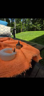

My mower has been starting intermittently and I believe the fuel shut off was the culprit. I removed it and cleaned it and the mower fired up and I can hear the shut off clicking again. Mowed for about five minutes and the carb flooded and now the oil is full of gas. Can someone help point me to the appropriate rebuild kit?

I went to the part tree website but not all the kits list what exact parts are in the kit. The tip of the needle is rubber so I'm guessing it seats on the carb itself? And there is no other seal? My float seems to be fine and I don't see just needle for sale anywhere.

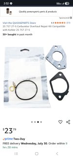

I googled the part numbers from the part tree and came up with this. I guess ill give it a shot. Im not sure where the smallest ring from the photos goes since i couldn't find a geat diagram. Thanks for the helpScreenshot_20250728_143202_Samsung Internet.jpg

If you are talking about the tan ring next to the float vavle that is the seal for the fuel solenoid on the bottom of the bowl.
