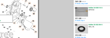

I've spent over an hour looking trying to find out if the crankshaft seals are the same part # for both front & back; all I can find just talk about the output end and not the flywheel end. Output end seal is pt # 25 032 06S. Does anyone out there know if both seals are the same. Thanks!

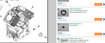

Will need the model number to verify the parts look up but,

Thanks for your reply - I can't for sure make this out(hate that I'm mentally declined). Looks like different seals but looks like same side of engine. Duh!

The first one i posted , that seal goes in the crankcase / engine block, the 2nd seal (25 032 06S) goes in the crankcase cover which is probably the PTO/output side, depending on application.
