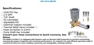

116
12,598
Auto Doc the OP is looking for a pump not an engine.
I'm sure the shaft is 20mm. Also, it uses a square, 4-hole bolt pattern. The 7/8" pumps I've seen use a triangular, 3-hole bolt pattern.7
Well there are four point mount pumps in the 7/8 line up.
But if you post the engine model and spec alpha numeric codes. Then we probably find what the PTO dimensions are and what will fit it.
