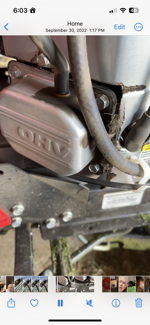

Just did my 50 hour oil change on my 2021 SPX with the 23hp Intek motor. Drained it using the side flex tube and it wasn’t as horrible as people make it out to be. You just need to warm the engine up first and then sit there and hold it while it drains. The oil that came out of it was remarkably clean, just somewhat dark but you could still see partway through it.
I did notice last month that both valve covers have class one leaks so I’m going to get those swapped out and the valve lash checked while I’m there.
I have been using straight 30w oil in my mower because that’s what the manual says. I was surprised that Briggs calls for 30w, I’d been putting 10-40w / 10-30w oil in my other Briggs & Tecumseh engines for years. Thoughts on the oil choice?

What exactly is a class one valve cover leak? Valves on Briggs don’t need adjustment until 250 hours.

It’s an Army thing, leaks are classified into three groups:
Class 1 - damp gasket, attracts dirt.
Class 2 - same as above with one or more drops of oil at bottom edge of joint.
Class 3 - leak actively running oil out of joint.
It’s hard to know who’s advice to trust, but I guess I’ll just stick with the owners manual. Clearly 50 hours is a little early basted on the look of what I drained, but oil is cheap, engines are not.
