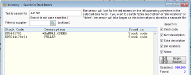

To UPup and away: I did find a P/N on the cable. it looks like an old AYP number. 441781. I can not find anything relevent when I google on it or put it in to ebay and the usual suspects.

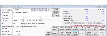

That number is listed as an operator manual under the AYP/HUsqvarna SKUs and is NLA.
And this the only SKU listed in my entire database other than a tool with the number within the PN.
Like I said, not relevant. Not sure what that number is on the cable.
