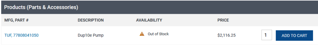

Okay guys this appear to be a Tuff Torq DUP10E unit. It may have a broken internal gear between the L and R cylinder blocks. It appears that Tuff Torq don't provide parts directly for these units and even JD don't offer the gears.
Here is a place that has complete units at a reasonable but please verify that you have the DUP10E pump before ordering.
DUP10E Pump Unit
And believe it or not Tuff Torq says they are out of stock and their price is only a measly $2,116.25 USD
