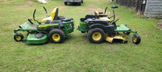

I willhttps://www.lawnmowerforum.com/attachments/img_20250611_115650811-jpg.71109/ just use it for parts or buy a new engine for 1,400.00 and keep it as a backup mower.IMG_20250611_115650811.jpg
