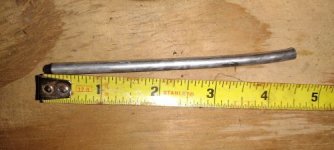

Took valve cover off. one exhaust and intake pushrods, one was laying under rocker arm broke, the other I assume is in the bottom of the engine. I ordered both rods, both valve tappets. Is there anything else I need to order?
Can rods be replaced without breaking down the engine?IMG_20250612_133536492.jpg
