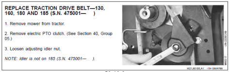

I have a old JD 160 trying to figure out how to replace the trans drive belt, looks like the steering gear has to be removed but I can’t figure out how to do it any help would be appreciate.

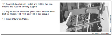

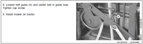

Hopefully your mower is 475001 or later if so here is the instructions from the service manual. Also hope it not a LT160 which I don't have the manual for.

Thanks Star Tech,very helpful had the belt off in 20 minutes. I fooled with it several hrs yesterday and could not see the forest for the trees, after i read your post and saw your pics a light bulb went off duh what a dummy thanks again. Do you have any idea what the belt number is local dealer give me 2 belts and they were both to short ( but that was before i had the old one off)
