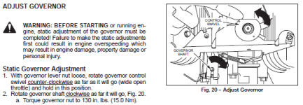

I have a BS Model: 445877 Type: 0760 E1 Code: 070213YG that I replaced the plastic intake with the aluminum intake and a new carb... Now the motor races and I have tried all day to not blow the motor up with the high rpm's but for the life of me I can't get it set up right. I have adjusted as the manual instructs but every time it just takes off... I am at a loss. Please help
