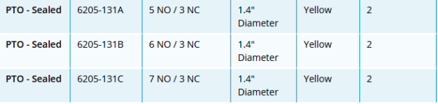

So they are upgrading to a 6205 10 amp sealed switch from the 6204 5A non sealed one.What color is the pto switch red button or yellow. If Red I would replace it with the new yellow 679534 switch. When you have it off take a look at the terminals in the plug and see if the center tabs in the terminals are broken out.
Now the question is which 6205-131 switch are they using? A, B, or C?
