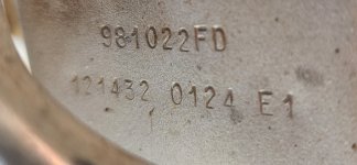

981022fd
121432 0124 E1
Its a 6hp on a tiller.
I dont have the manual for this engine but i know someone here does! I need to see the proper specs for the compression cause either my gauge is lying to me or this thing runs at super low compression im getting like 65lb on my tester. It runs but not the greatest tho ive only just started messing with it recently.
