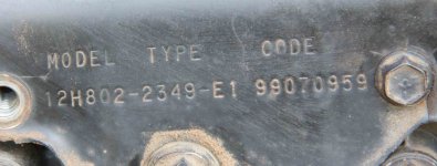

I need to locate a source for a new intake manifold for a 6.5 HP B&S engine. I think the model No. is here:
The manifold looks like this (disregard the JB Weld):
I need the part No. for the manifold and the gasket. It doesn't have the bump on it like this one:

497645, superseded to 794305
So, you can search using one of the above numbers, but most likely you'll get sent 794305.
Thank you for providing the model and type numbers up front. (y)
the one you linked appears to be for there slightly smaller Classic series engine with the gas tank mounted on the carb.
