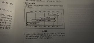

In my owner's manual it shows 10w30/40 or sae 30 for my temperature I'm operating at. Which is the best to use? It clearly states right below the oil chart that multi grade oil will increase oil consumption. Should I go with the sae 30 then?

Use whatever oil you want to use. You may just have to check the oil level before using the mower, which you should be doing anyway. It won't have enough increase oil consumption,if at all, using multigrade oil over straight 30w to worry about. Unless you are planning on using the mower more than 8 hours at a stretch before refilling with gas, and checking the oil, and other things.
The most important thing is having oil and the correct amount of oil, not what grade of oil is in the engine.

Even better get some Mobil Delvac 15w-40 for about the same price ($15).
https://www.walmart.com/ip/Mobil-De...5231658403&athposb=0&athena=true&athbdg=L1600
SAE 30 will do a fine job but I found my ZT having a hard time turning over during the cooler months when I was running it.
In cooler climates multigrades have the advantage over mono's for the very reason you have mentioned.
Multigrades are less viscous at lower temperatures than monos, so offer less resistance to cranking (easier faster starting) and better cold engine circulation.
