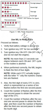

  • / I have B&S 679 efi. It's been in the shop 4 times and each time it comes back it's still showing the same trouble codes E-1 and E-4 . Any ideas ?
What are MIL trouble codes?
