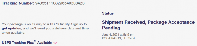

Then you had better than me as I ordered a pin and rod for Hustler Fastrak an it been sitting the Florida post office since June 4. I have been trying to get a straight answer about the part for the last three weeks. Great service until you have a problem. I finally just made the part.
Here the tracking just looked up a few minutes ago.
