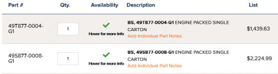

Hmmm, IL my PD source is showing it available. Now of course its the PD out Ohio.

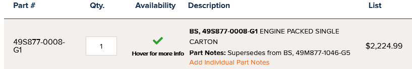

ILENGINE
May 6, 2010
11,369
  • / Husqvarna MZ6128ZT 28 hp Briggs engine no longer available?
@StarTech Interesting that I am getting the exclamation point triangle with the 49S877-0008-G1
116
12,596
It possible that your PD account is defaulting to a different warehouse. Back in October and November I had a fellow tech on another forum that the 793880 camshafts in the PD Mid West warehouse came in stock nearly a month before they made it to the Ohio warehouse. It took a while for us to figure this out too.
