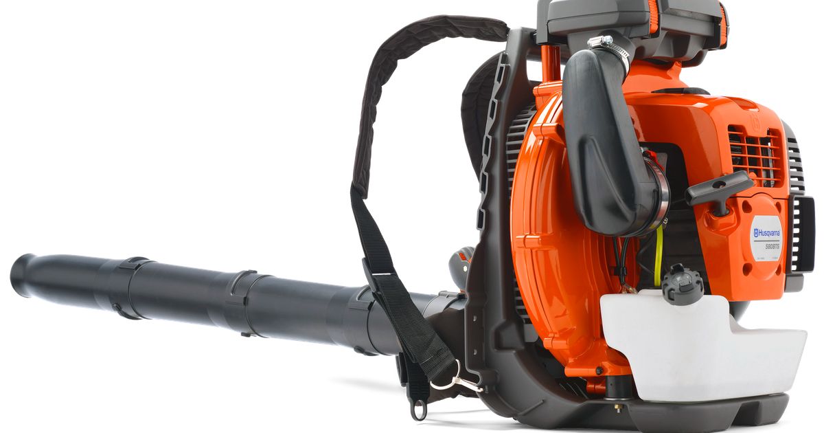

Hi I'm hoping for some help with my blower. It's a Husqvarna 580 BTS Mark 2. I can't get it to start. I have tried a few things. I have replaced the fuel filter, replaced the spark plug, put a new air filter in, put in a brand new carburetor. I have checked all connections and the two fuel lines. I am confident the fuel is good since all of our other equipment has used it and didn't seem to have any issues. It does start up with starter fluid, which i would assume means the ignition module is still good. Anyone have any thoughts? Ideas? Suggestions? Any help is appreciated. Thank you.
