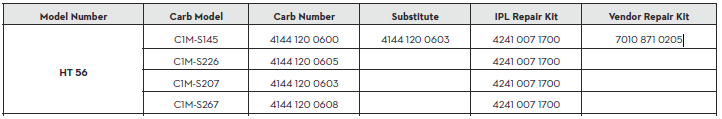

Besides Bert it should have a Zama C1M carburetor. The problem is getting any repair parts for the carburetor as Stihl has a stranglehold on Zama now here in the USA and any repair kit for the carburetor is nearly as expensive as a new carburetor or at that is the case here. The full repair kit is PN 7010 871 0205 from Stihl that if the local dealer can even get it. The 4241 007 1700 is just a GND kit.
