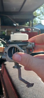

I'm sure it's hard to tell through a picture, how's my float level look?
In person it has a slight, slight, downward angle.
Forest#2
Apr 17, 2022
605
I've seen quite a few of them plastic floats look like that, non adjustable and the carb still operate great. At first I tried installing another jet, then another float and still same. It's usually on them single cylinder Nikki's that I see such.
I eventually just accepted that it's a normal thing and not causing the the lean condition the Nikki's are know for where they run better with a slight choke.
Summary: I do not think that is float not being level is what is causing your Tecumseh issue.
this particular one is adjustable as the part where the needle clips on is metal.
