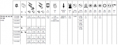

First is OEM carburetor or after market? Even OEM carburetors can have the metering set too low from the factory but aftermarket carb are hit and miss as if they are good or not.
On initial set mixture screw to 1-1/2 CCW from fully seated position. Yes Stihl has different initial settings but this is the will start settings as they are constantly subbing carburetors. You will need a tach to make these adjustments. Also make the plug gap is set correctly as noted below.
There are times when you got to start with LA all the way in to start adjusting things.

From your first post appears changing the carb did not affect the idle problem. If you installed an OEM carb with the mixture screws set to the correct initial settings per the chart Star provided and it won't idle here are things to check.
