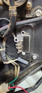

I had a friend walk me through some stuff with a light I had. Put it across the fuse holder and it only lights up with key switch is on. Then he had me hook it from the positive of the battery to each contact on the plug that the key switch plugs into. Verified the light lit in the proper positions but also, to what I show is the A1 red wire. Took off the hood and unplugged the headlights. I've looked over the wire I can see. most everything is black plastic wrap. I wasn't sure if it made sense to start pulling this off. On the right side of the power there's a Molex (I think that is the term) by the voltage regulator (flat silver box with 3 prongs). The red wire going out of this goes to the voltage regulator. There are green and black wires with heat shrink (I think) that go up into the motor. I can pull the red wire off the side of the voltage regulator and still have a short. But it I pull the Molex the light goes off. Does this prove my short went away or does the fact that there's green and black wire mean I removing something I need to troubleshoot. Assuming that isn't the case where else would everyone look? I have a wiring diagram (I think but it's for the Kohlar model, assume it's the same?), but I'm having a really hard time even seeing the wiring. I have tried wiggling stuff around (that I can get my hand on) and the light doesn't change.

The tiny aluminum gadget with 3 wires connected is to voltage regulator. Unplug all of them and see if it still blows the fuse. If it does blow, you have likely got a problem with the electric PTO clutch or the wiring going to it.

Last night I disconnected the red wire and the black connecter with 2 white wires from the voltage regulator and my light stayed on. I still have a black wire on the top that goes to the starter (I believe). Should I try re-disconnecting the voltage regulator and the black wire? Is the light a good test or will I actually need to use a fuse (I know I will need to for final test)? I have a pack of 5 fuses, but could get more if needed.

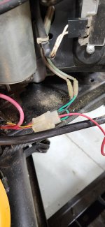

20250912_074705.jpgThis is the connection I can open and it turns off my test light

Pulled all connections to voltage regulator this morning and test light still comes on. Would trying with fuse be a better test?

So it appears that plug I pulled apart goes to the fuel solenoid and that must provide a path to ground or at least enough to light my test light. Because I unplugged right under the solenoid and the light went out. At this point everything was hooked up but the headlights and the solenoid. Put the fuse in and was able to see hour meter and even crank. So then hooked the fuel solenoid and still OK. Friend had me try the headlights just to be sure, and it blew the fuse. The headlights were the first thing I tried, so if I would have waited until my wife got home from town with the new ones and just tested that way I would have been up and going in about 30 seconds! Let me know if there is a way to show this solved or complete. Thanks everyone for taking a look!
