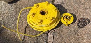

Got the machine running now (a little intermittently at time) - thanks for all your help.
As you can see from the first set of photos, I have this sort of trimming head; yellow with six drive lugs on the spool.
Can anyone tell me how you are supposed to advance the line feed on these heads as it's certainly not a bump head? Maybe loosen the nut, pull apart the spool and head and twist 60 degrees perhaps?
Thanks
Is the head orange plastic with the bottom like a big upside down cup that has like 8 holes that pins fall in???
If so, you pull it out then turn it to give it more string then the pins fall back into the holes.
With the pic of the threads, maybe you should look at the Stihl(again) FS36 head if u find doing this annoying. It looks familiar.

If I lock the circular part above the arbor with a drill bit through it into the hole below, do I just then put a spanner on the square section and turn? If so, is it CW or CCW to loosen? If I do manage to get it off, I take it I can look for a replacement arbor (e.g. a Stihl compatible one) so that I can fit an 8" twisted wire brush weeding disc (which is what prompted the question about the thread designation in the first place)?

It's as per this photo.
I've taken to loosening the bottom tri-lobe nut sufficiently to pull the spool far enough down to disengage the six lugs. I then turn it 60 degrees anti clockwise and pull on each of the two line ends to lengthen each by an inch or so. Repeat this far too often unfortunately as I'm strimming agains concrete so the working length shortens very quickly :(
That would just remove the adapter bolt Fish posted. That would leave u a bolt for a cutter head or the like which you would need to buy a LH\RH nut.
(sorry I just noticed now, the yellow head with 6 pins- same as mine just not orange and not 8 pins. I was thinking 8 off top of my head.)
When u remove the adapter, if u get a female thread, maybe the FS80 tap head bolt adapter to fit current tap heads fits yours...

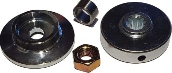

Yes, the arbor comes off like a bolt/nut, reverse thread, and you can attach a blade, or another universal type head. They will come in a form like this.
Great - thanks again. And for the benefit of my 36" Stilsons, CW or CCW to loosen?
Edit: just re-read - CCW to loosen. Thanks.
