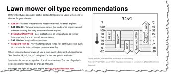

here is what Briggs suggests. No one around here sells the Vanguard oil. I'll find something similar.
Maybe it is just because I am in my mid-70's now but my head is spinning on this. The present oil API ratings that Briggs suggests is SF, SG, SH, SJ (or a generic statement "or higher"). The Vanguard 15W-50 oil is CK-4 which is a diesel rating. Most oils today are SN or SP. I feel like Briggs is not even paying attention with their recommendation. SJ and older is for "2001 cars and older". SF, SG and SH have been obsolete for 20+ years. CK-4 is diesel. The recommendation screenshot came from their website TODAY, not 25 years ago.
