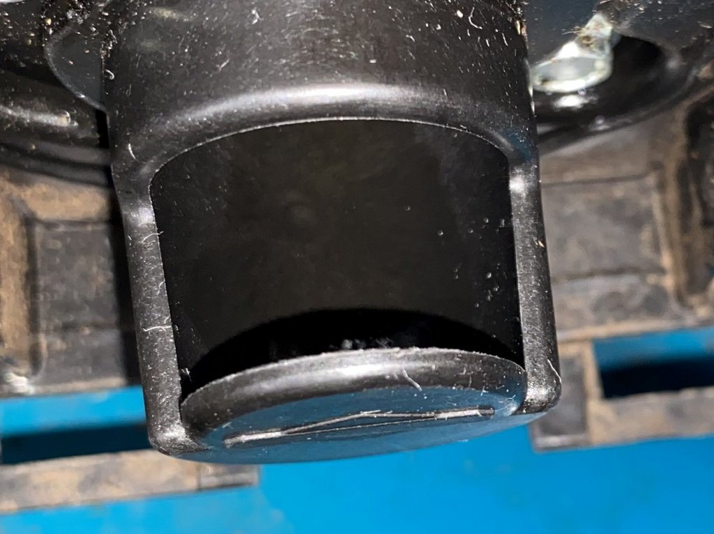

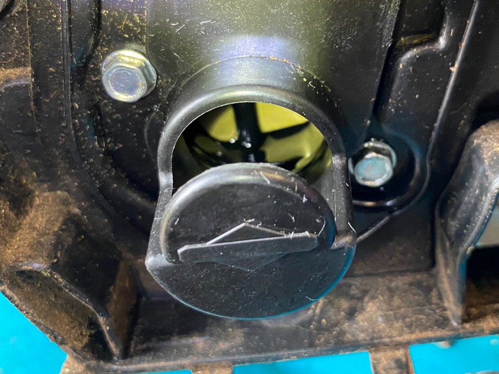

Hoping you guys can point me in the right direction on how to fix this issue. I've had this mower since 2015 and lately it's the first time I'm having problems with it. I'm not familiar with mower parts and all that but I'll try my best to explain the issue.

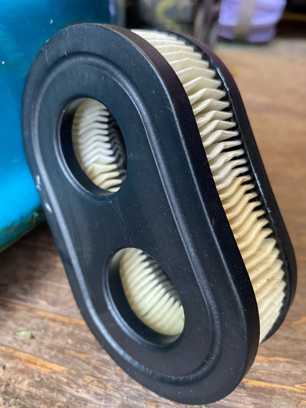

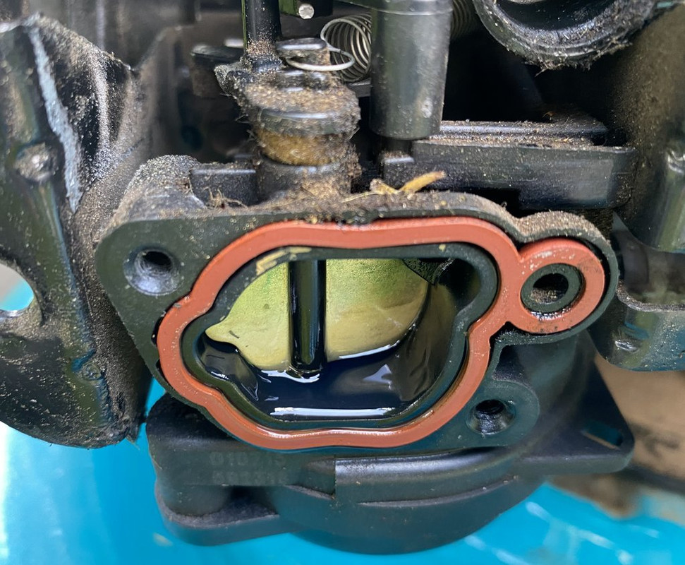

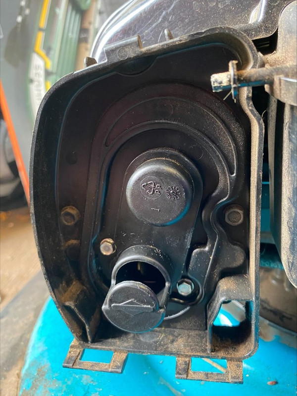

The last three times it didn't sound like it was running right. And it did burn out white smoke one of the times for a few seconds. As you can see in the pics, the air filter appears to be soaked with gas. It looks and smells more like gas to me than oil. And there is enough oil in there as I checked with the dipstick.The previous filter was totally soaked as I used it a couple of times before I put a new one in that now is half soaked.
I see that in the bottom hole there is gas accumulated, which I soaked up with a paper towel. And there's a flap there that was in the open position. I used a pencil to poke it and close it. Not sure what that is called. Is that for air to be released but somehow gas is leaking down into there and coming out the opening when the flap is open?

The carb float valve is not shutting off the fuel supply
Remove the carb & clean it and in particular the float needle
Depending upon which carb you have fitted it may need a new needle

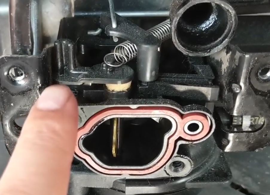

I followed this video. Same engine as mine. What happens is that the little plastic post rubs up on the metal bracket and get's stuck. It's on a spring and in the video he pulled it towards him, let it touch the bracket and let go. And it got stuck. So that flap is stuck open when you go to start. So he shaved off the excess plastic on the left side of that post and then demonstrated that it no longer comes close to touching the bracket. I did the same thing and my mower started right away.
Well, the second time I went to go start it, which was a week later, it took a dozen tries. And this happened three days ago as well. Both times, the flap is not stuck open. It's closed like it should be for startup.

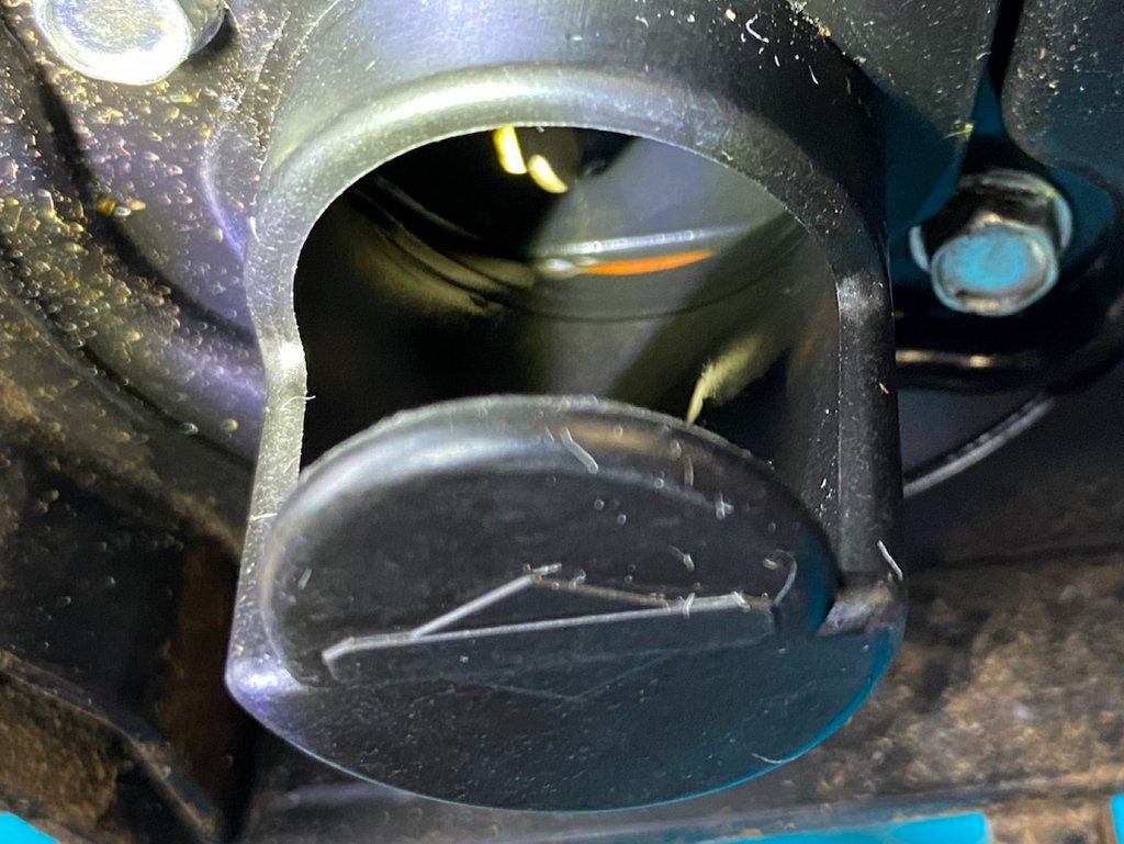

Now, as you can see, gas is sitting in there so it's leaking from somewhere. Would that be related to the carb float valve not shutting off the supply like you said?

As Bert said, the float needle is not sealing and letting the bowl overflow up into the venturi of the carburetor.

Well, I got the needle replacement and put it in. Reassembled the carb after a cleaning and the mower started on the third pull, which was an improvement from the dozen + attempts previously. But took out the filter afterwards to look and I have gas pooled like as shown in the first couple of pics. I left the same filter in that I put in two mowings ago and I left the dirty side down. So next time I'll put the clean side of it down and see what it looks like. Though the mower sounded better than the previous few uses.
When I picked up the part from the local shop, I brought in the carb. He said the needle looked fine but it's usually the culprit so I got the new needle anyway. He said the seat in there is made of brass while the needle has a rubber tip (existing and new one). He said sometimes the seat is rubber while needle is all metal. He didn't see anything wrong with the seat but he'd have to order one as they don't have in stock. I could also try polishing it with metal polish and qtip as I saw in some videos. Or order a whole new carb, which I will check on now regarding the price.
He also said he was surprised to see a brass seat. He asked if I had modified it before. I haven't touched it since I bought this in 2015.
#12
M
megaman123
I have mowed twice since. The clean side of the filter remains clean. And it starts first or second pull. Before both times I soaked up the gas that pooled like in the pic. But when I was done I looked and there was no gas pooled. But out of curiosity, the next day I would pull off the filter and look again and both times gas is pooled. No idea if that is normal.
