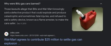

I have 6 of the 5gal Blitz cans I keep full and sealed for the generator. Have had them for 25 years. No problems. Too bad idiots put them out of business.
