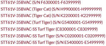

Depends which the OP has as there three or four different engines and one of them is an EFI engine. So the engine info is needed.
Also which one of the seven STT61V-35BVAC is it?
