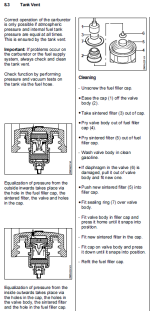

Thanks that does make sense. BTW how is the tank supposed to be vented? as far as I can see the cap is not vented and then its only the supply and return fuel lines - or is there a vent somewhere else?

The cap is usually vented , you can just loosen it up and try and see if it makes a difference
116
12,591
To me it sound more like an ignition coil problem so check for spark when it stops working.
Otherwise the info of the tank vent.
