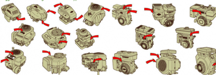

get the engine model, type and code numbers. Should be on the OHV valve cover

the carburetor is part of the engine assembly, you need the engine model which is in the picture you posted.
a wire brush or find sand paper/scotch brite will take care of that rust to make it easier to read.
