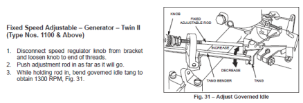

OK so pictures of the carb & the kit as there is about a 0,01% chance that any one here has ever set one up but a 99% chance ones seen some will know where the bits go .

Briggs Opposed Engine Fixed Speed
Does your engine have a normal mower throttle plate on it ?
IF so hook the rod into where the throttle cable wold normally go then fit the bracket to where the cable clap would go
You might have to fabricate a support bracket for it or just use a piece of angle iron / heavy shelf bracket shortened & drilled to suit .
