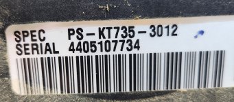

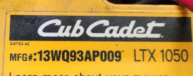

Hi everyone.
i have a Cub Cadet 13WQ93AP009 LTX 1050. Its garage kept and has 200 hours. The engine is a Kohler KT735-3012 MTD.
I used it the other day and after about a hour it shut off. It was completely dead. I got it in the garage and found the main 20 A fuse was blown. Replaced it and it popped as soon as I turned the key 1 position. Guess that would be run. It has the reverse safety switch. I don't like it but I didn't engineer it. I just ride it.
I went through and eliminated all the safety switches first. still blew the fuse. now I had about 5 blown fuses. Anyhow, I unplugged the wire harness that feeds the ignition/charging components. the fuse didn't blow. So, I figured it was probably a shorted voltage regulator/Rectifier. Seemed like a appropriate part to start replacing. I also checked all the wires for shorts and noticed the red wire going to the fuel solenoid shut off. So I unplugged it from the solenoid, plugged the wire harness back in and it didn't blow. I wanted to be 100% and I plugged the red wire back into the solenoid while the harness was plugged in and the fuse didn't blow. The mower started up and ran perfect. So now I'm confused about what shorted. I would still like to change the rectifier that I already got in the mail today and the fuel solenoid. The solenoid is a being a issue though. All the parts diagrams online do not list a number for the solenoid. I checked Kohler and they didn't either. but at the bottom of the parts list they had a fuel solenoid rebuild kit. I searched the number and at some stores its over $100 and comes with what looks like the mounting gasket for the entire carb, the bowl gasket, the solenoid and the solenoid gasket. the ones I've changed just unscrew and you screw the new one in. I emailed Kohler and asked about it and its been since last week with no response. If I can just replace the solenoid I need a number. when I put the engine number and solenoid into google search a lot come up. My problem is I have no clue if the ones coming up will fit as I don't have a number. I'm hoping someone has worked on this motor before and can give me some advise.
Thanks for any help.

They went from a one wire solenoid to a two wire hence the kit. Part no. 32 757 01-S. $56.26 retail.

Sounds like wire on anti afterfire solenoid on carburetor is chaffed and shorting to ground and popping fuses. Purchase a new solenoid and replace, track down wire bad spot, or, bypass the solenoid and be done with issues forever. Your call.
11,424
The Kohler kit PN is 32 757 01-S.
But trying measuring it and see if it matches the following. If so then there is an aftermarket version under Briggs PN 694393. Now the Briggs OEM solenoid is just as high priced but on Amazon there is one for about $12
Also the Briggs one may look like this so when ordering order the aftermarket version that matches your current solenoid.
Just note Amazon is now requiring $35 minimum orders here for free shipping. May be only be $25 in your area just depends if they hit your area yet.
