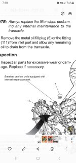

Look on page 12 of the service manual.
Yep and here it is blown up. My maverick with the 3200s looks the same... wonder if there's a passage way were there's only air

I found my problem here with the manual mine is a 2020 and the newer 2023 SM is different...Updating my files to the newest repair manual. So I can be on the same page guys. Just download the older from HG back in January.
Boy I free like an idiot for not checking if a newer manual was out.
IF we look in the 2023 manual page 28 (PDF page 30) HG explains this new feature. There is an internal expansion tank that was added to some version of these transaxle.
