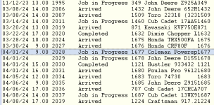

Just to give an idea here is what is currently in my small shop for repairs.
And Yes I know a Z925A has been in the shop for a long time. At least the customer has two other ZTRs that are his primaries mowers. Weather and health has delayed getting it out but it should out in a week. Nearly fully reassembled but rain is holding me off now.
And it appears the new style ignition JD is using has a high failure rate. I done found two in less than a year. This AUC18708 switch is expensive too from JD @ over $85. Anyway I ordered two this time so one be on the shelf for the next failure.
