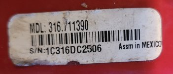

316.711390 (MTD 41ADZ32C799)
Carb is a Walbro WT-973 (MTD PN 753-06190)
