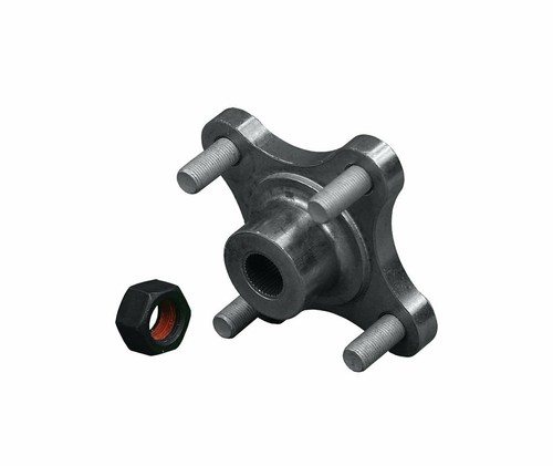

I need the 14 digit model number of the hydro gear. There are three 4 bolt hubs and one 5 bolt hub at least.
Plus you will need the hub puller to remove the hub from the axle.
Nut, Patch Lock 3/4-16 240 - 260 lb-ft (325.4-352.5 Nm) Hub Nut. So it will be a very hard pull as it will nearly pressure welded on the taper.
Model number is ZU-KPEE-3C0A-3JLX

Well let's see if you want go thru a Hydro Gear dealer.
Dixie Chopper PN 67002 is $188.10 and Hydro Gear lists the same under PN 71446 for about $55.
There is one on eBay for around $59 including shc.

I will look for the model number. I may have to cut old hub off with air hammer or something because I have two broken lugs
Star Tech is right ZU-GPEE-3C0A-2JLX is the correct part no for the trans axle have one in my shop. 71446 is the right hub no. $54.58 retail.
