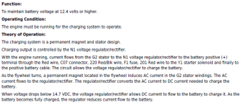

First the magneto coils really can't tested by the user or most shops. The internal electronics simply can't be tested. The valid test is the the high voltage secondary side. For most of us it is plug and play. Otherwords either an install coil works or it don't.
As for the charging system.
