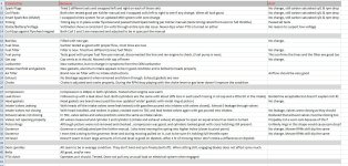

I'm absolutely baffled by this issue. I am now 100% out of ideas. The problem presents itself in two ways.
1. Within the first few moments of average load mowing, the motor RPMs dip significantly (about 5-10 seconds after engaging everything ). The greater the load, the more the RPMs dip. I hooked up at tachometer and it shows 1200 at low idle, 3600 "high idle", and during mowing it will usually sit right around 1700 RPMs depending on load (barely enough to mow). If it's a downhill, it'll go to 2500 or so, and small uphills dip to the point of basically being at low idle speed. If at any point I pull back the sticks to a stop (blades engaged), rpms will slowly pull back up to 3300+ RPMs (in 3-5 seconds). Push the stick forward and it dips back into the 1700 range.
2. Using clean plugs, cylinder #1 plug is always turns sooty black (carbon fouled) after a ten minute mow. Cylinder #2 is white to very light brown (varies). But never rich like #1.
I've put together a spreadsheet to track this problem. Just because after checking EVERYTHING I wanted to make sure I didn't miss anything. I know it's a lot, but it will show that I've tested all the typical problems.
