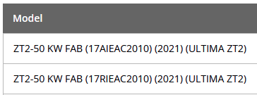

model and serial would help. I tried to find a manual for it but ZT2 was not enough.
#14
T
tbmmbt
It is a Cub Cadet ZT2 50” zero turn mower 2021 model

Then it is one of the two below:
Both has the same drive system using the Hydro Gear ZT-2800 transaxles.
