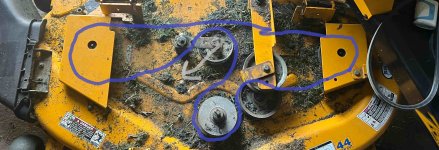

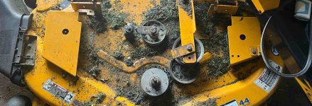

So, I inherited a much older Cub Cadet Z-Force. Mechanically, it’s in fantastic shape. It just needed some new wheels and a deck belt.
Model: 53AA5B6L712
I was able to find the correct deck belt and the diagram sticker is only partial on the mower and of no use. I know this is a much older Cadet and searching online has only made me more confused.
Can anyone help me figure out the routing for the deck belt?
Looking at the parts manual hasn’t been much help because there is a pulley that doesn’t look as if it matches up. Any help someone can provide would be a life saver.

This has the belt on the deck and also one the comes from the engine PTO to drive the deck? I have a Z-Force 48 that is setup that exact way.
This picture may help.
The deck should also have a routing label on the left front to show exact belt placement. Note: It is easy to get the PTO belt on the wrong side of the pullies (I know this because I did that, and I've been a mower mechanic for many years)
These are even more fun if you have to replace the drive belt and tensioner pulley. It's not that bad if you have a way to lift the entire rear off the ground and remove the drive wheels to lower the cradle section.
These units were well built, but tricky to work on.
I'll see if I can get you a picture of my deck label belt routing.

I genuinely can’t thank you both enough. I know I’m not a total idiot but for whatever reason this put me in a corner and finding so much close but different manuals and information online has a bit too much.
And now it looks like I may have the wrong size belt. I had purchased a 5/8x80” but after finding the right manual it may need a 1/2x82”. So, back to the store I go this morning.

The belt situation worked out perfect. I exchanged what I had for a 1/2 x 82 and it provided just enough of a pain I knew it was the right one. When I disconnected the deck I remembered that someone else had mentioned greasing fittings too and had taken care of that in between the belt issue.
The PTO belt and I did come to an understanding and that understanding was unbolting the front links all together, marking where they were and sliding the deck back to make it easier to get the PTO on. When I slid everything forward and bolted the front links back on it fell where it needed to.
Everything ran fine after that. PTO engages as it should and the pulleys spin great. I did notice that someone has the bars at different angles and that was a bit annoying so i straightened those up.
