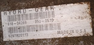

I bought a used Cub Cadet LT1046 for almost nothing. The deck was what needed the work, so I went through and repaired/replaced a bit of stuff. I mowed my yard and it ran great, until it stopped. The drive will not engage forwards or reverse. The pedal moves the linkage, but nothing happens. No movement of the drive pulley. It's full of fluid, but it's obviously old.
I am getting frustrated in trying to look up stuff online about it. The tag on the transaxle is below.
I can't find the 350-0510 reference number anywhere. There is 310-0510, and the tranaxle looks the same, but it's not the same number.
Can someone point me to a guide or video about working on this? I put enough work into the rest of the mower that I want to take a stab at the transaxle before I give up and count it as a loss.

If the transaxle input pulley is not moving then it is the mower drive belt system that is the problem. But I will attach the transaxle repair manual and the IPL.
Repair too large to attach so here is a link to my online drive. Just be aware this is temp link and the file will get deleted in a couple weeks so DL and save on your end. If the manual says it for a different but this is correct per Hydro Gear.

You wrote this:
Are you saying the drive pulley on top of the transaxle is not spinning???
I feel like a total dumb-@$$ now, but sometimes that's what it takes to clear things up. The problem isn't the transaxle. The belt that drives it from the engine isn't moving. Duh.
