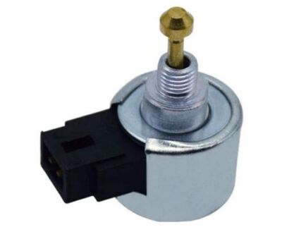

Finding one the Nikki could be a problem depending on the clearance under the carb. I think the Briggs 596038 will work. It should be threaded M8-1.00.
Here is an aftermarket one you could try. It has a metal head instead of the hard plastic.
And here is the Briggs 596038.
